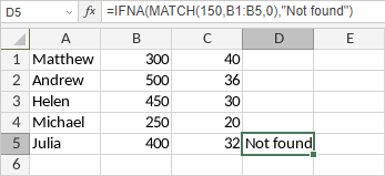

The figure below displays the result returned by the IFNA function.
IFNA Function
